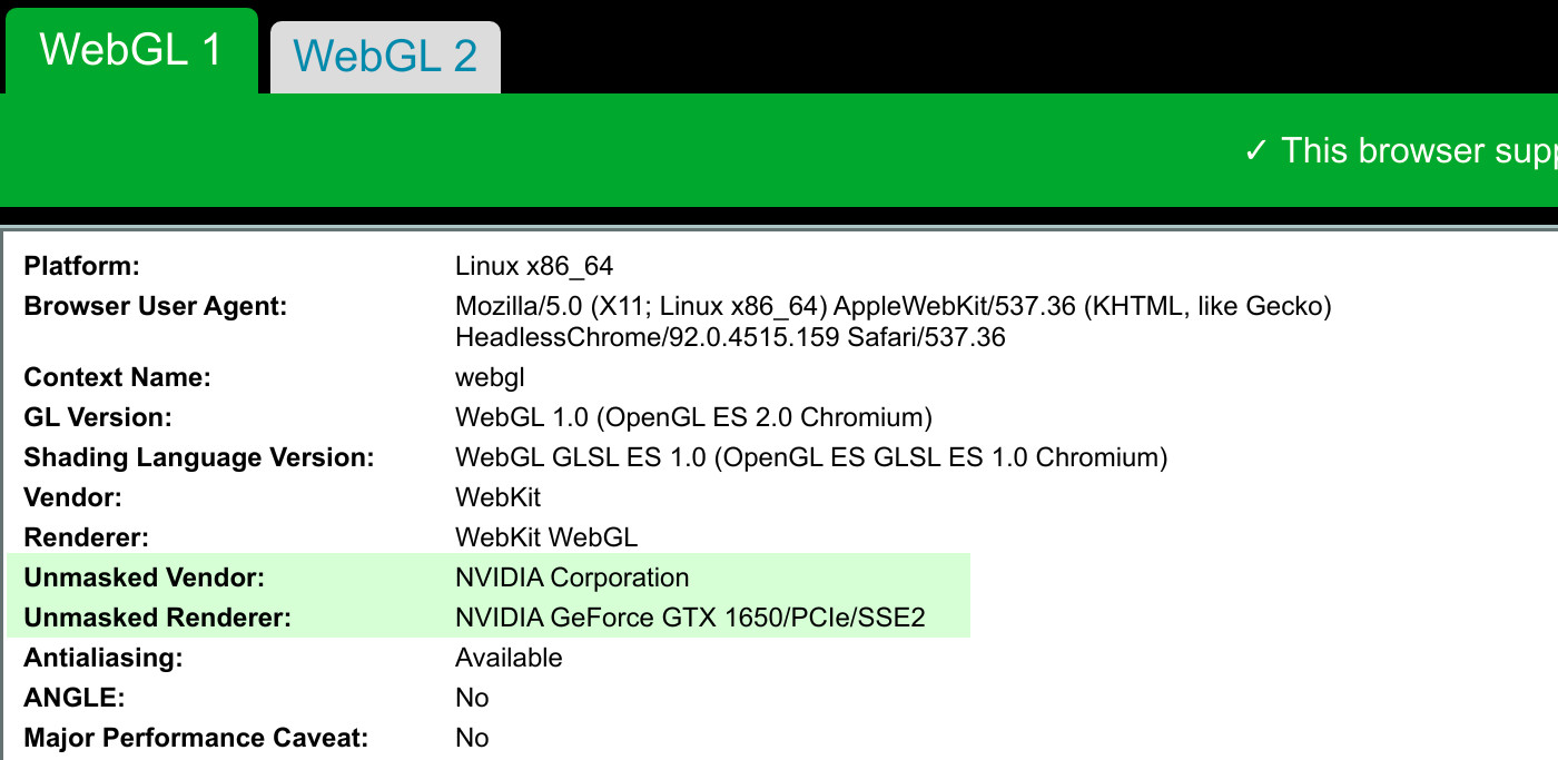

google-chrome --headless --use-gl=egl https://www.soft8soft.com/webglreport
The --use-gl=egl option enables accelerated GPU rendering in headless mode:

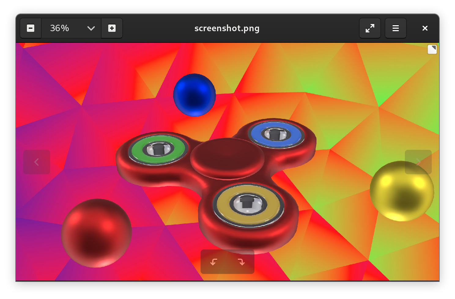

Place the code as screenshot.js in the same directory you installed Puppetter and launch:
node screenshot.js -u https://cdn.soft8soft.com/demo/applications/spinner/spinner.html
to take screenshot of the Spinner application and save it as screenshot.png image:
