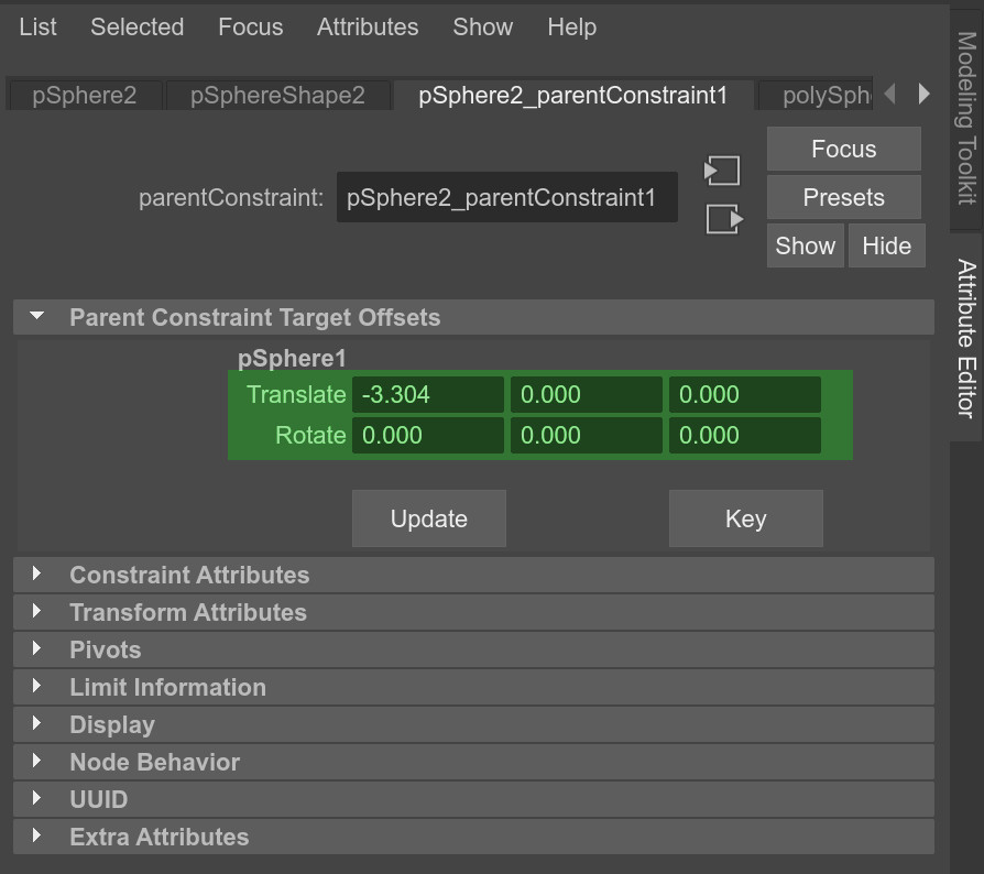

Parent
This is the constraint version of the standard parent/children relationship between objects.
![Maya parent constraint](files/constraints-maya/parent.jpg)

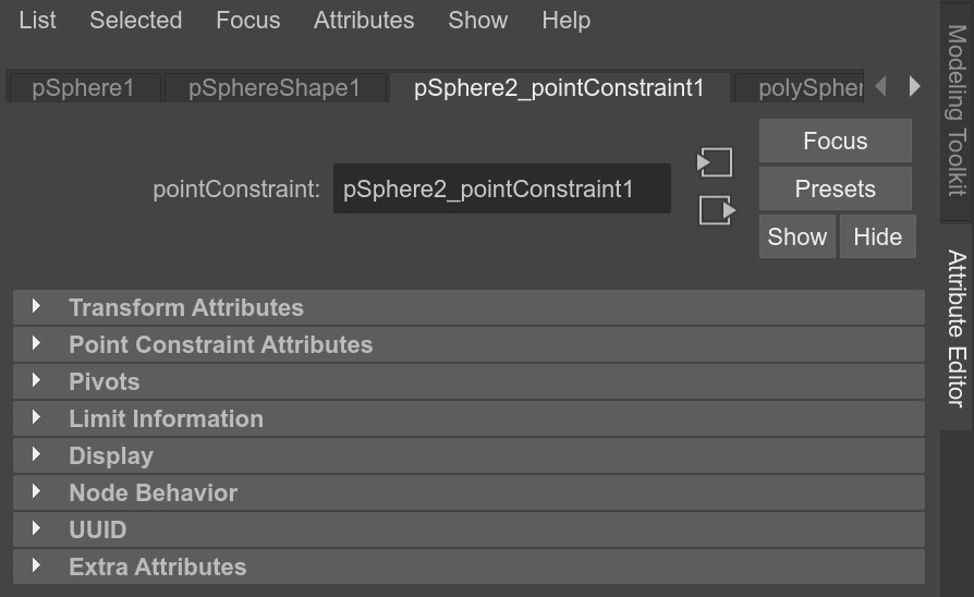

Point
This constraint forces the object to which it is applied to have the same location as its target.
![Maya point contraint](files/constraints-maya/point.jpg)

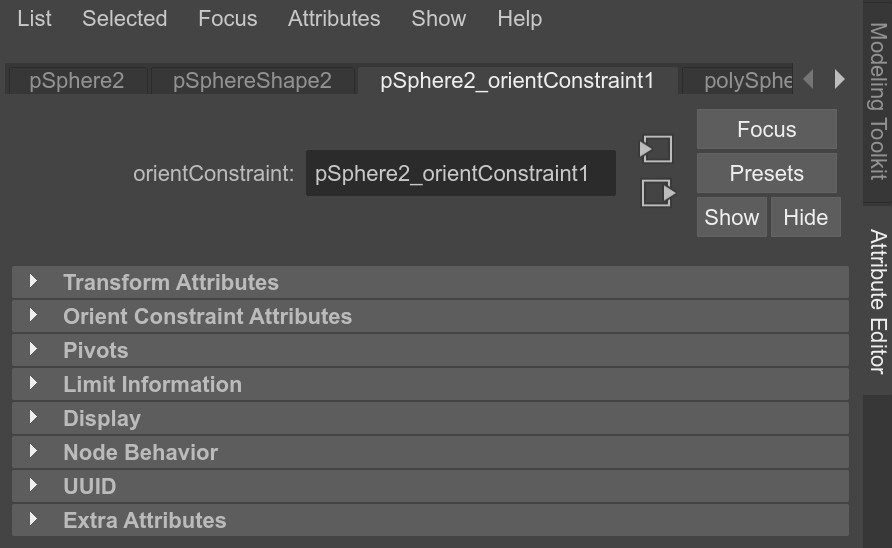

Orient
This constraint forces the object to which it is applied to match the rotation of its target.
![Maya orient constraint](files/constraints-maya/orient.jpg)

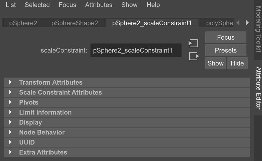

Scale
This constraint forces the object to which it is applied to match the scale of its target.
![Maya scale constraint](files/constraints-maya/scale.jpg)

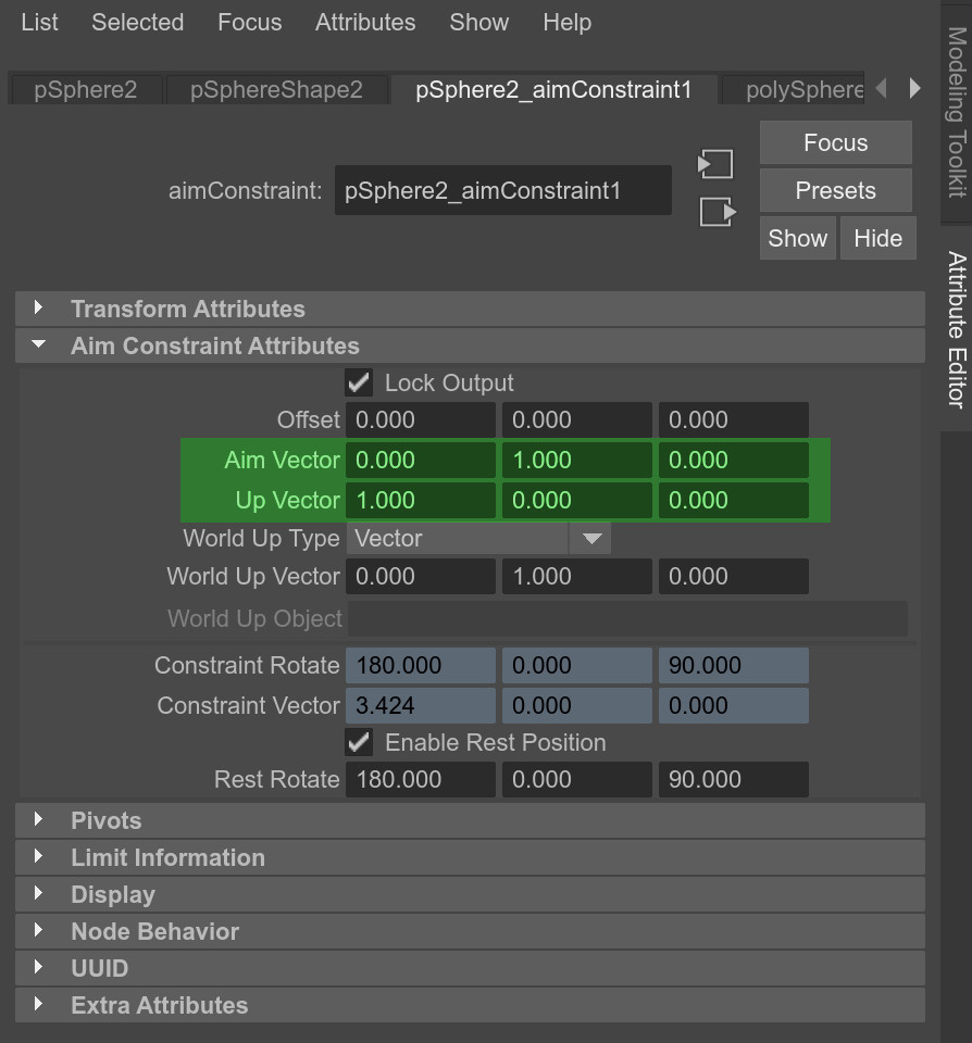

Aim
This constraint applies rotations to its owner, so that it always points a given Aim axis towards its target, with another Up axis permanently maintained as much aligned with the global Z axis as possible. Thus you can implement billboarding with this constraint.
![Maya aim constraint](files/constraints-maya/aim.jpg)
Verge3D does support only axis-aligned Aim and Up vectors such as [1,0,0] or [0,-1,0].

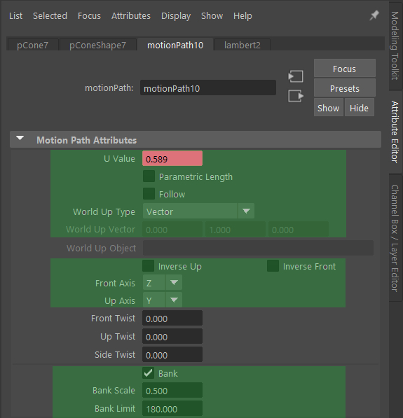

Motion Path
This constraint restricts an object's movement along the path (curve, shape).
![Maya motion path constraint](files/constraints-maya/motion-path.jpg)
1. Verge3D does support only Vector in World Up Type selections.
2. The follow checkbox must always be active otherwise the constraint will not be exported.
