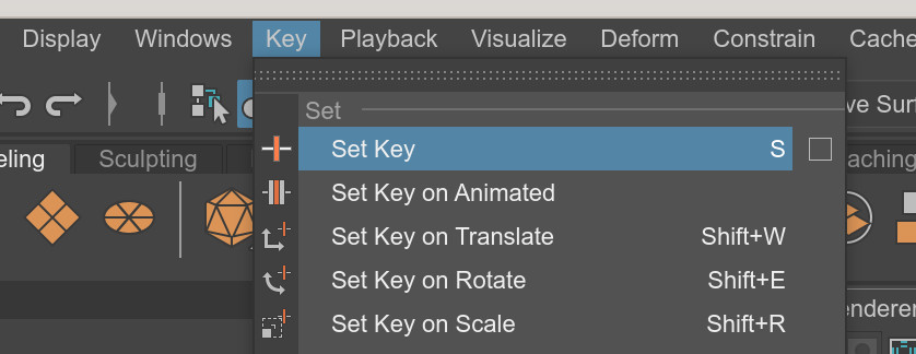

Whole-Object Animation
Animation keyframes can be added in standard way in Maya, by using the KeySet Key menu in the Animation mode set or pressing S on the keyboard.
Inserting keyframes in Maya
For performance reasons we recommend setting keys separately, only for channels which are required to be animated, e.g:

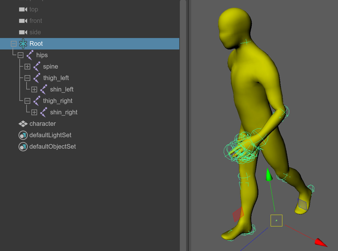

Skeletal Animation
An object can be animated in Verge3D by using Maya's skeletons. Verge3D support maximum 4 weights per joint (4 most influential weights are selected, others are ignored).
Inserting keyframes for skeletal animation in Maya
Skeletons can be animated directly by setting transformation keys on joints or by utilizing auxiliary controllers such as IK handles/effectors. To animate bones indirectly, enable Skeleton Root and Custom Frame Range property on their common parent object and set proper From/To as frame values. See below for more info.

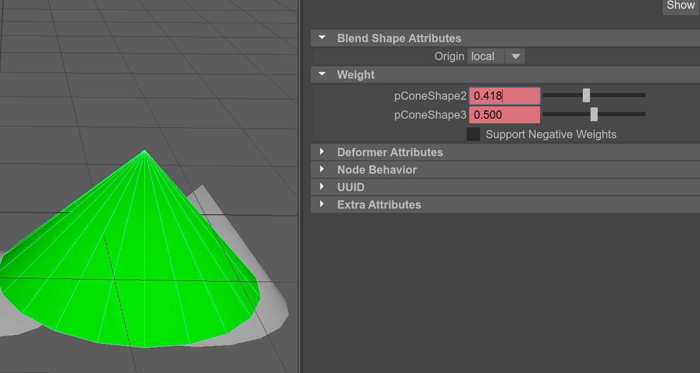

Blend Shape Animation
You can add blend shapes to an object in standard ways in Maya and then animate their weights using keyframes.

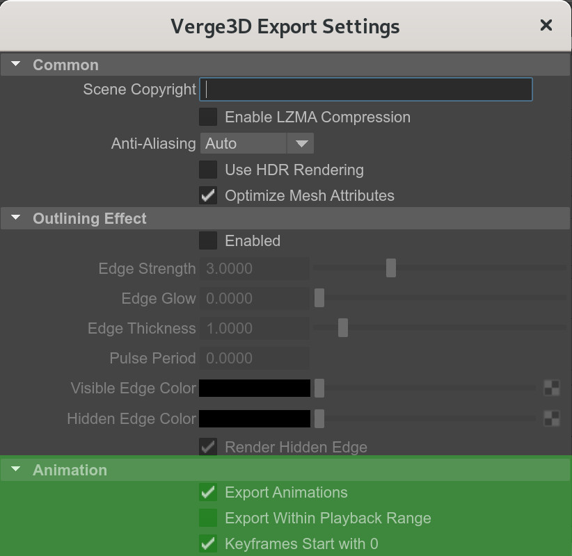

Verge3D Global Animation Settings
By using the Animation section of Verge3D Export Settings you can assign global animation parameters which will affect all animatable objects in your scene.
Verge3D for Maya animation settings panel
Export Animations
export scene animations to be used in Verge3D.
Export Within Playback Range
by default Verge3D exporter honors per-object animation keyframe ranges. Enabling this option will force exporter to honor global playback range.
Keyframes Start with 0
edit exported animation keyframes so they always start with frame 0.

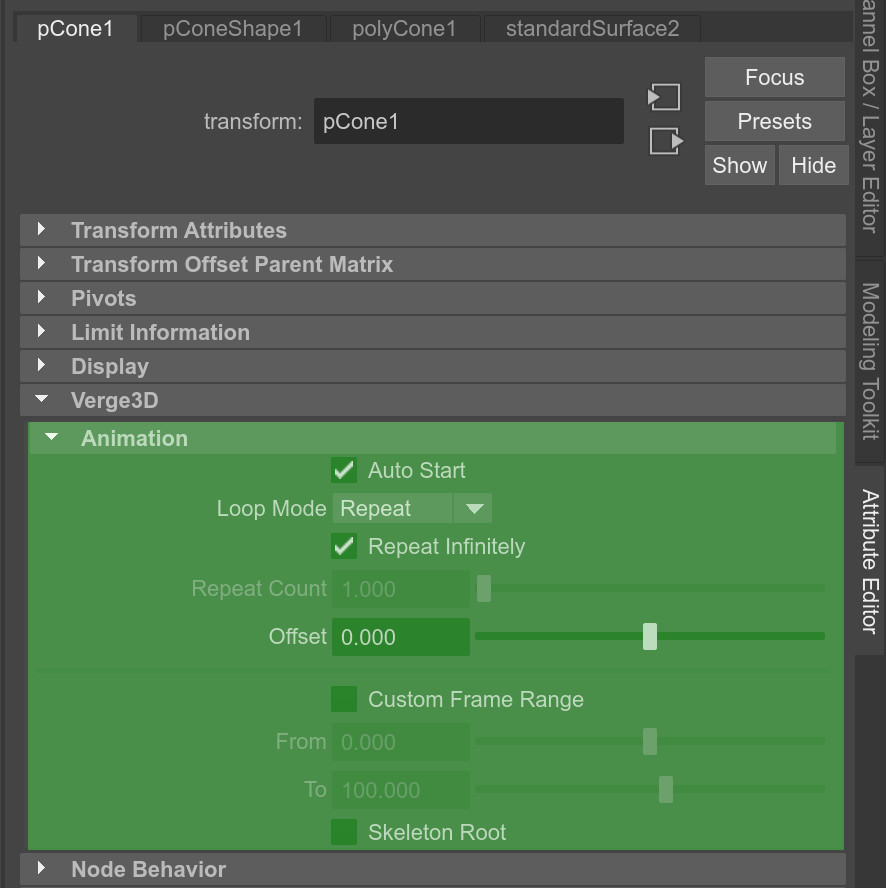

Verge3D Per-Object Animation Settings
Each object in Maya is assigned with Verge3D-specific settings, including the settings for animation playback.
Animation settings:
Auto Start
Whether this object's animation will start after the scene is loaded.
Loop Mode
Playback mode: Repeat - plays from the start to the end and repeats, Once - plays one time and stops, Ping Pong - plays from the start to the end and then in reverse.
Repeat Infinitely
Whether this object's animation will be played all over again. Valid only for Repeat and Ping Pong modes.
Repeat Count
How many times the animation will be played. Valid only for Repeat and Ping Pong modes if Repeat Infinitely is disabled.
Offset
How many frames will be skipped before the animation starts.
Custom Frame Range
Enable and specify From/To values to override object's keyframe ranges or global animation timeline. Activating this property will force an object to be animated even if it does not have any keyframes. This is useful to bake indirect animation such as IK handles/effectors affecting joints movements.
Skeleton Root
Consider object a skeleton root, e.g make all child bones inherit animation parameters from that object.

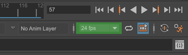

Frame Rate
The frame rate value (default - 24 fps) which affect the playback speed can be changed using the Playback options panel, located next to the Range Slider.
