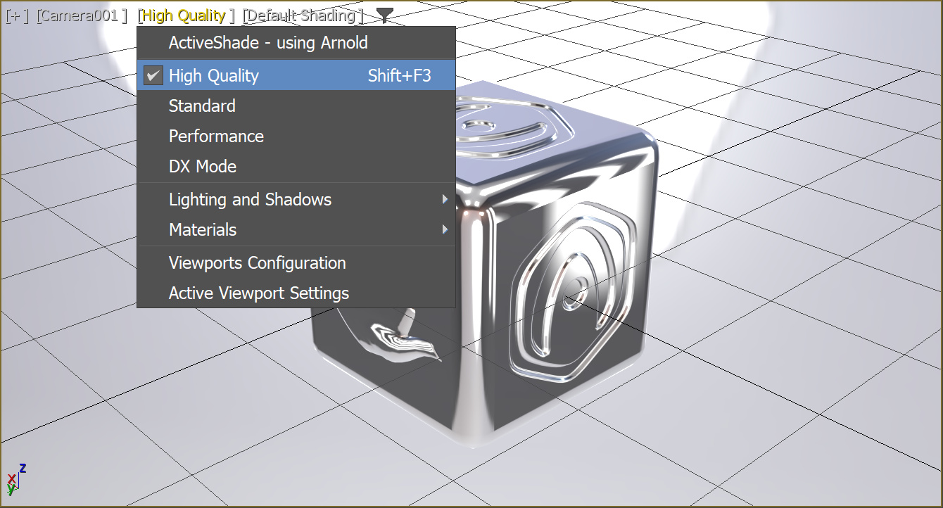

To enable better viewport preview in 3ds Max, switch from Standard to High Quality in the viewport settings:

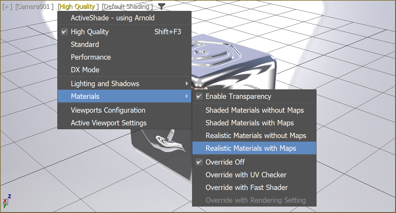

    Click Realistic Materials with Maps in the Materials submenu (this operation is required every time you add a new material):

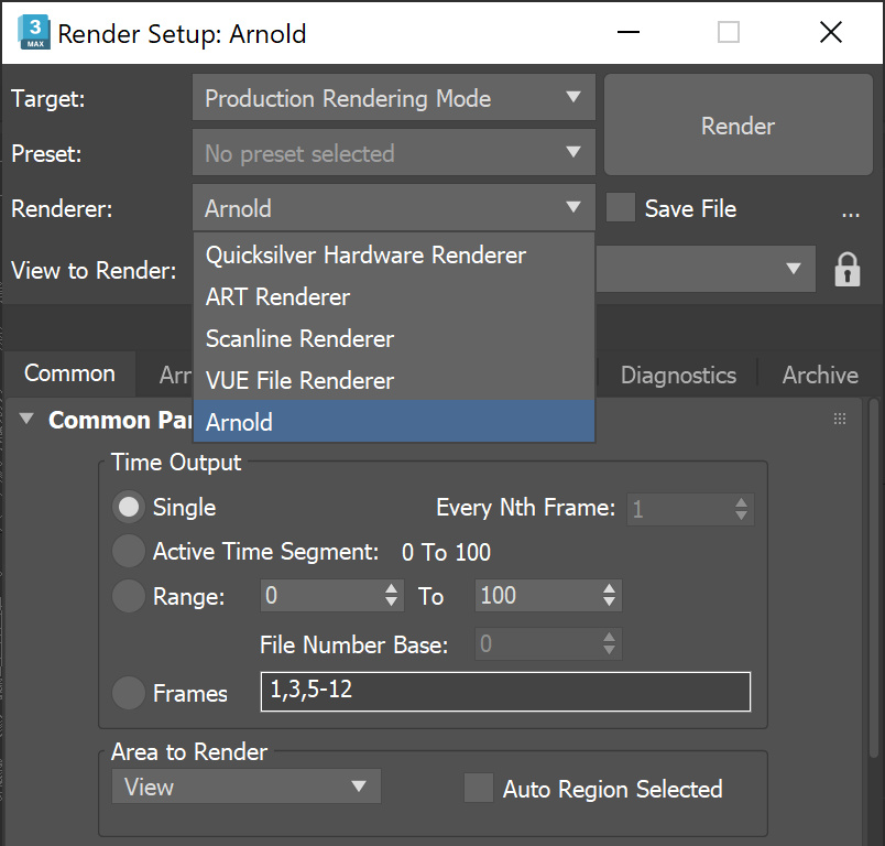

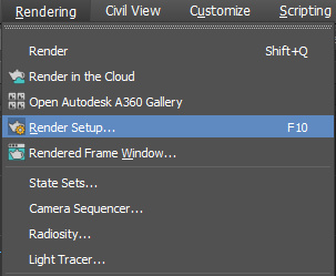

To select the renderer, click Render Setup... in the Rendering menu (F10):
    In the window use the Renderer dropdown to switch between Arnold and Scanline:

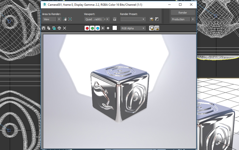

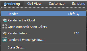

    To render a scene, click Render (Shift+Q):
    Subsequently you can use the Render button to repeat your render:

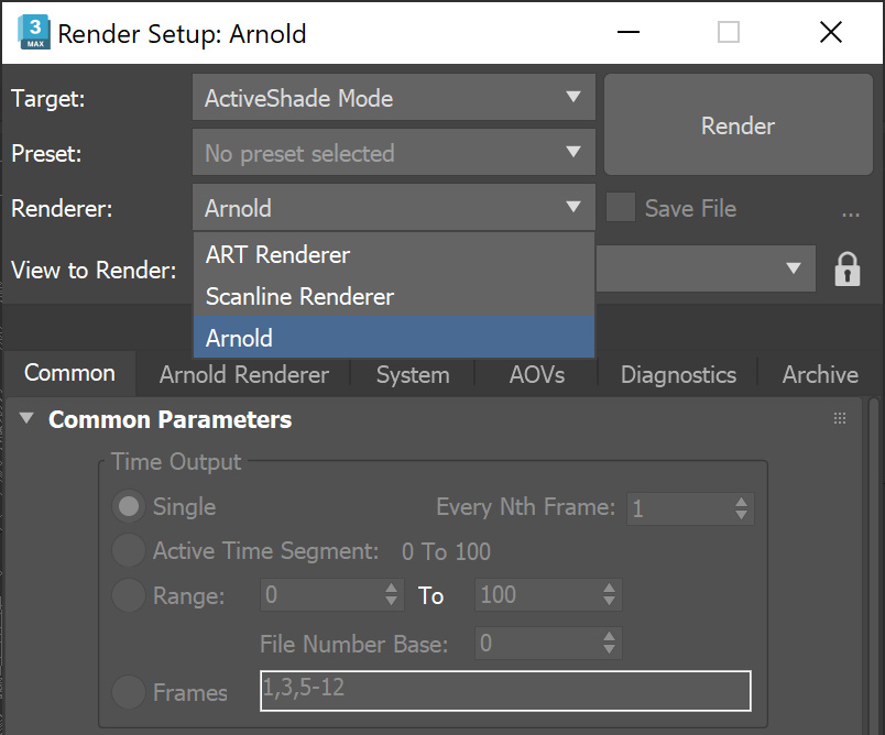

For faster iterations, you can use the ActiveShade mode which automatically updates the render every time you modify a scene (works best with Arnold render).

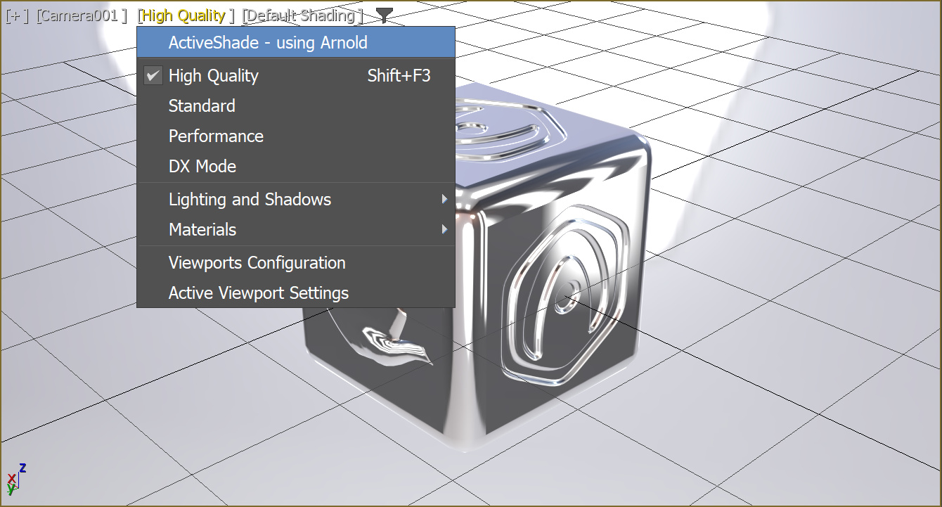

You can enable ActiveShade in the Render Setup... window:
    After that you'll be able to switch a viewport to ActiveShade mode:
    This way you can achieve a better approximation of what you get in the browser, at a near real-time speed.
