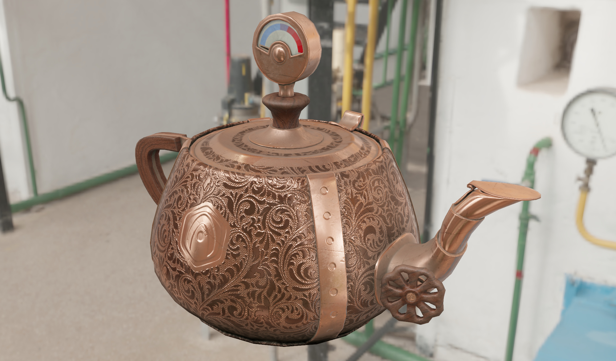

Physical Materials

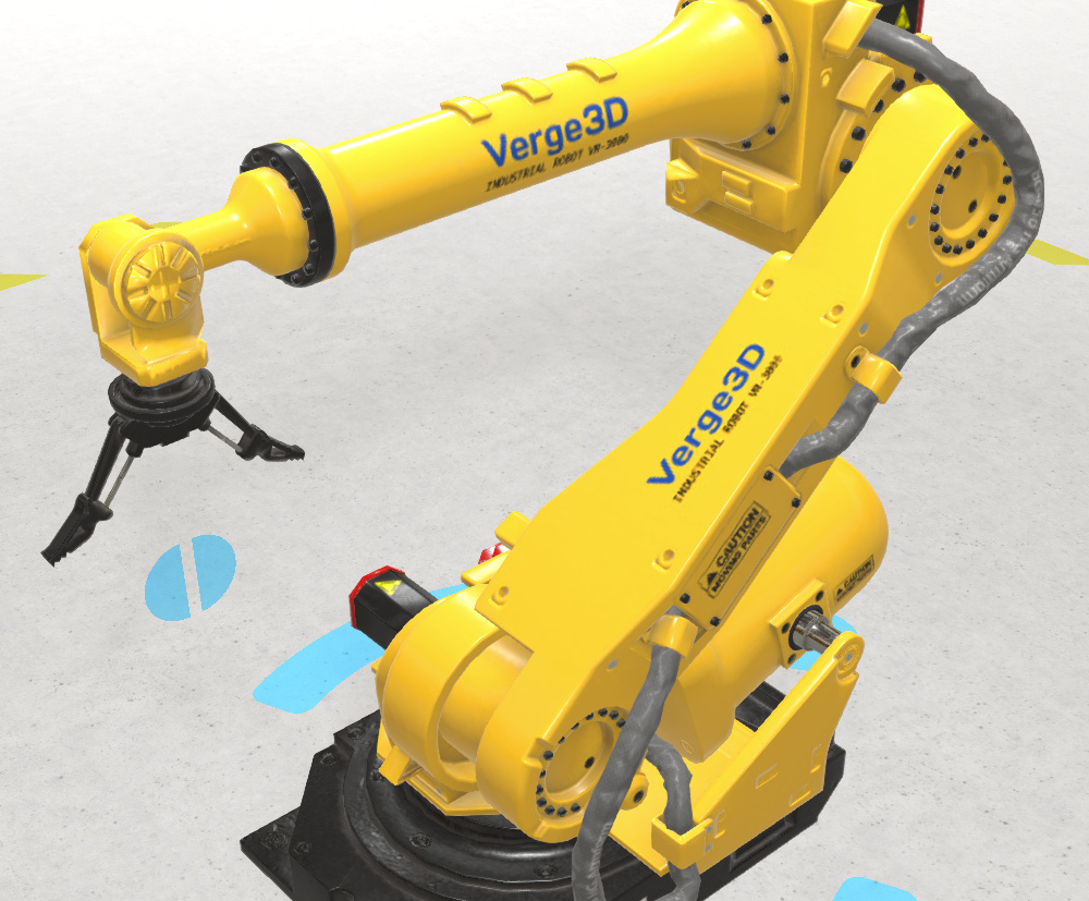

Physical materials are GPU intensive, but look more realistic and also easier to use than standard materials. They work especially well for representing metallic and other non-trivial surfaces. Verge3D strives to reproduce physical materials using Autodesk ART renderer as a reference.

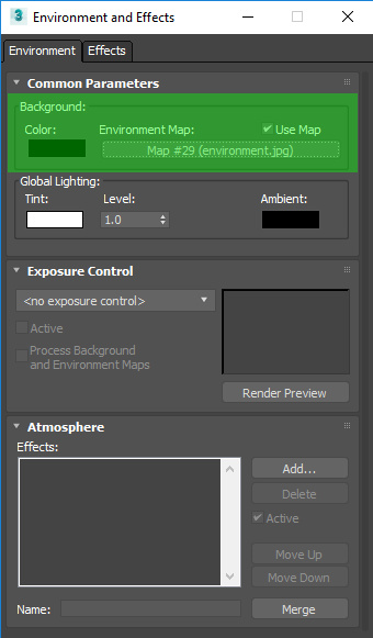

You can set up the environment texture using the Environment and Effects window.

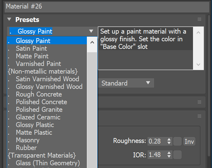

Most 3ds Max' presets of physical materials are ready to be used with Verge3D.

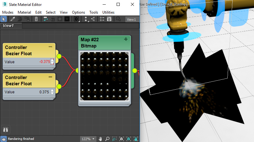

Material parameters can be animated or changed with Puzzles or with code using Float or Point4 material Controllers.

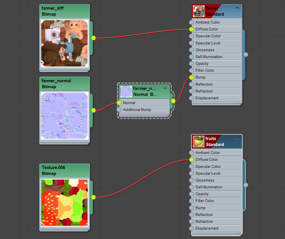

Standard Materials
These are default materials in 3ds Max which are well suited for viewport display. Verge3D strives to reproduce them using Autodesk Scanline renderer as a reference.
Standard materials are flexible and powerful enough for creating various setups.
Material parameters can be animated or changed with Puzzles or with code using Float or Point3 material Controllers.

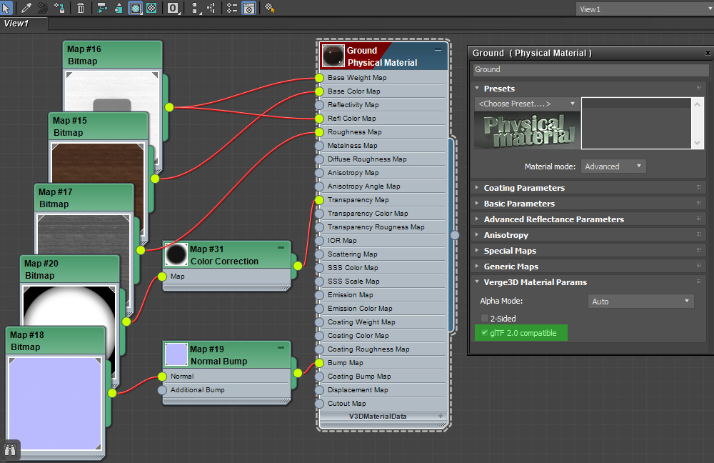

If your content needs to be compatible with glTF 2.0 standard for some reason, you can use physical materials for this purpose as described below.

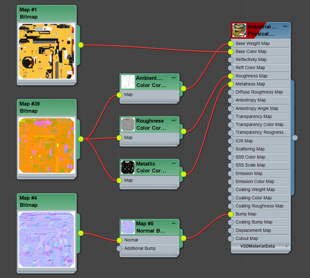

According to glTF 2.0 standard, material information is encoded in a set of textures: base color, occlusion-roughness-metallic packed in R, G and B channels respectively, and normal.
You must, however, use separate bitmaps for occlusion, roughness and metallic. Verge3D will automatically combine them in a single texture upon export. Be sure to enable glTF 2.0 compatible checkbox in the material settings panel.
Please refer to the glTF Materials section of this User Manual for more information on how to set up these materials.
