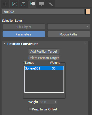

Position
This constraint forces the object to which it is applied to have the same location as its target.

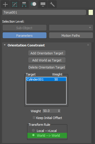

Orientation
This constraint forces the object to which it is applied to match the rotation of its target.

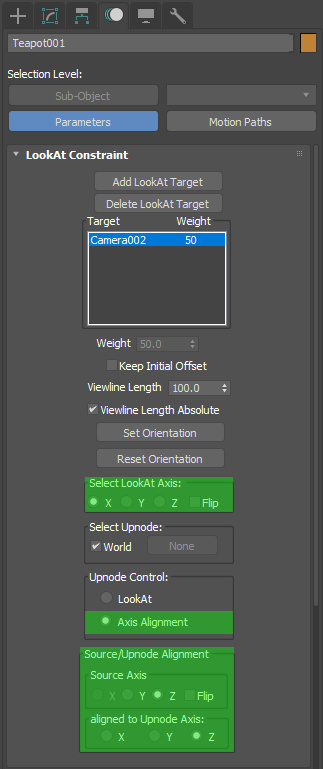

LookAt
This constraint applies rotations to its owner, so that it always is looking towards its target. Thus you can implement billboarding with this constraint.
