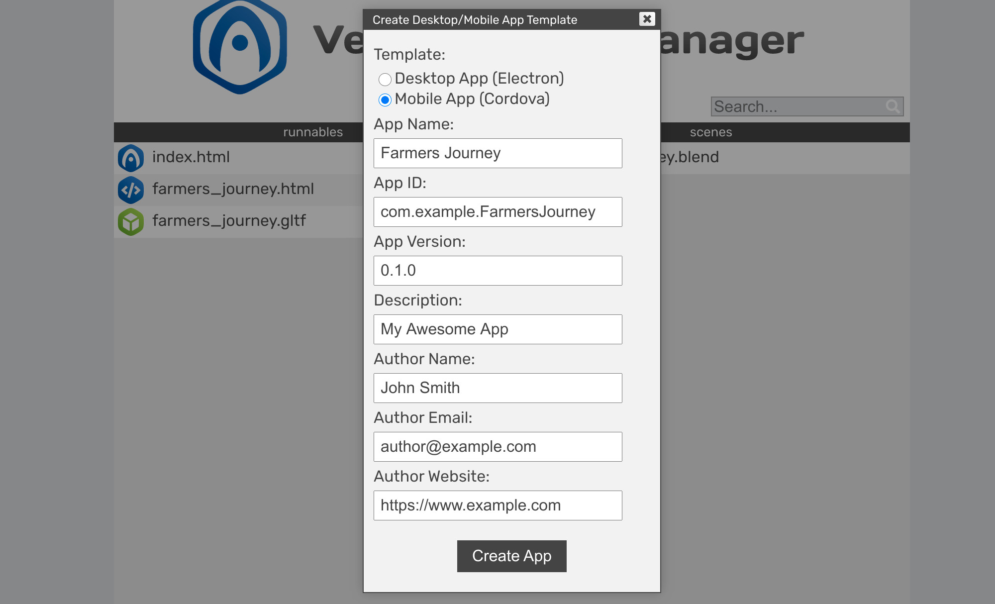

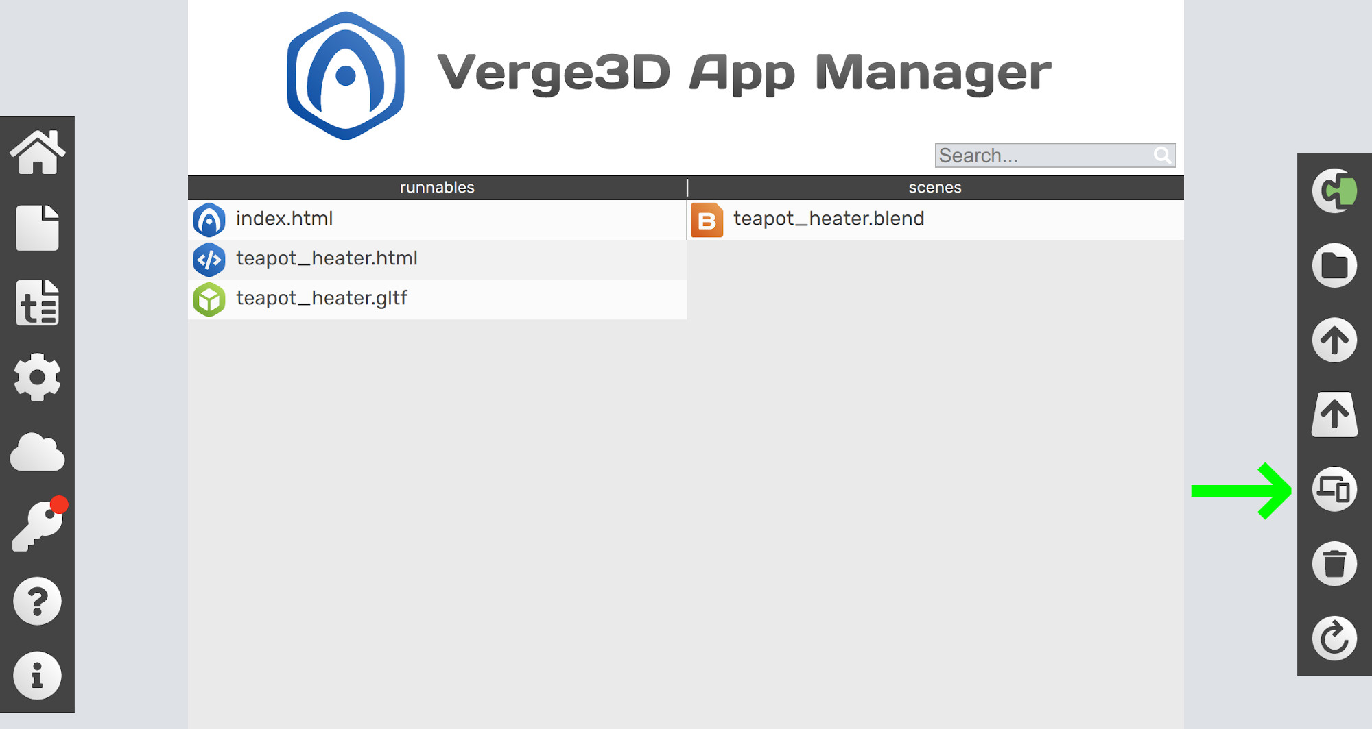

You can create your mobile app manually or with Cordova command-line utility. However, to simplify things up, we integrated a Cordova template builder right in the App Manager.
By using it you can create a Cordova app template right from your Verge3D app.
Once your template is ready, download it and then unpack the zip archive to some directory.

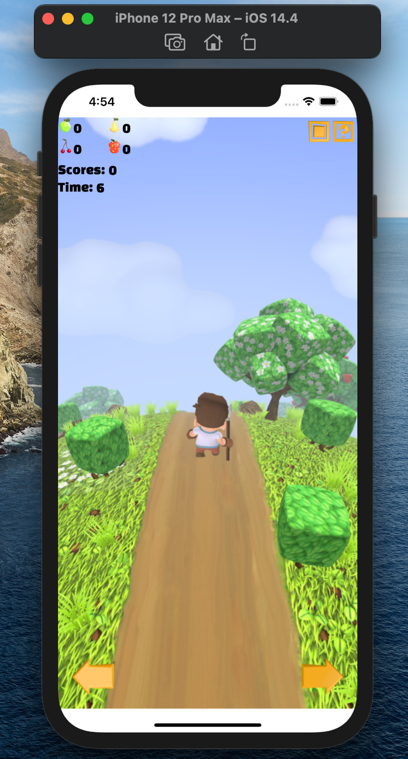

It's time to run your app, exec:
cordova emulate ios
to build and run it in the iOS emulator.

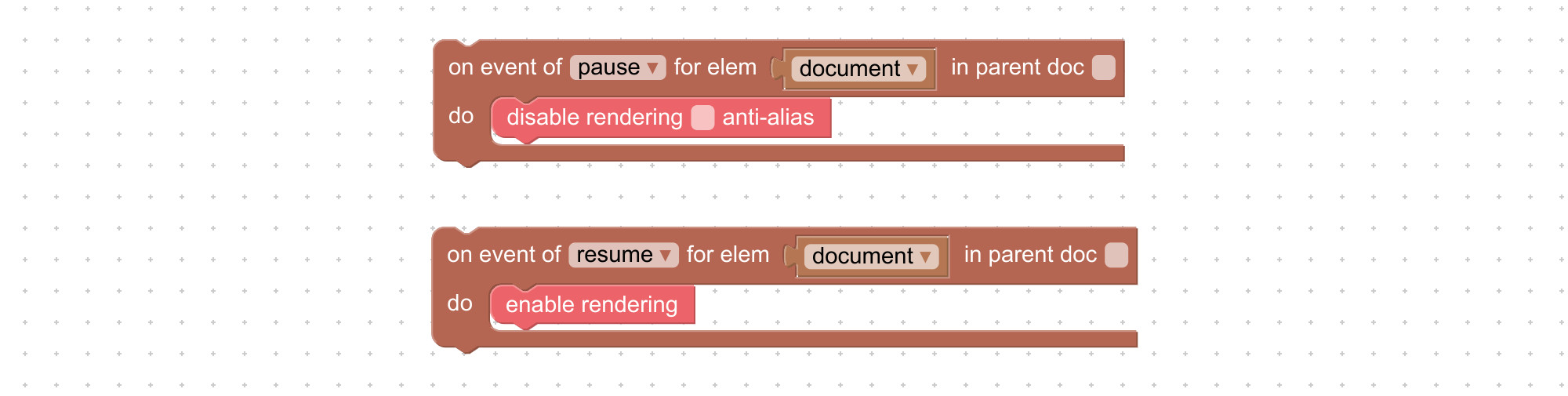

There are 3 Cordova-specific events available via JavaScript or Puzzles which you can use to make your apps more mobile-friendly:
- deviceready — triggered when your app is fully initialized. You can also use it to detect when your app is running on Cordova.
- pause — triggered when you app goes to the background or got switched by another app. Use it to pause your app rendering / sound playback / videos etc.
- resume — triggered when you app becomes active. This event is the opposite of the pause.
Make sure you register these events on the document element. Also, use the in parent doc option in case if your app runs in the iframe (see more info about this setup here).
