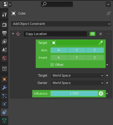

Copy Location
This constraint forces the object to which it is applied to have the same location as its target.

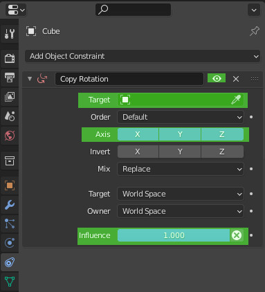

    Copy Rotation
This constraint forces the object to which it is applied to match the rotation of its target.

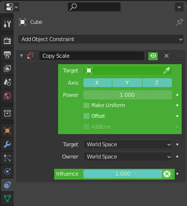

    Copy Scale
This constraint forces the object to which it is applied to match the scale of its target.

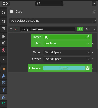

    Copy Transforms
This constraint forces the object to which it is applied to have the same transforms as its target.

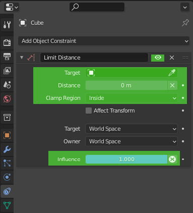

    Limit Distance
This constraint forces its owner to stay either further from, nearer to, or exactly at a given distance from its target.

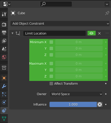

    Limit Location
This constraint restricts the amount of allowed translations along each axis, through lower and upper bounds.

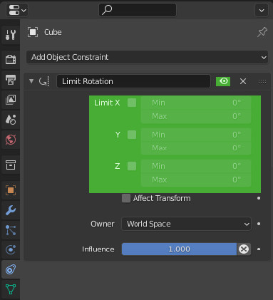

    Limit Rotation
This constraint restricts the amount of allowed rotations around each axis, through lower and upper bounds.

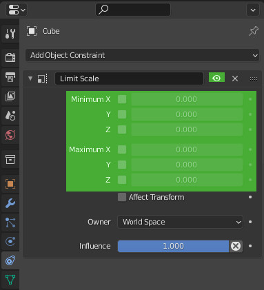

    Limit Scale
This constraint restricts the amount of allowed scalings along each axis, through lower and upper bounds.

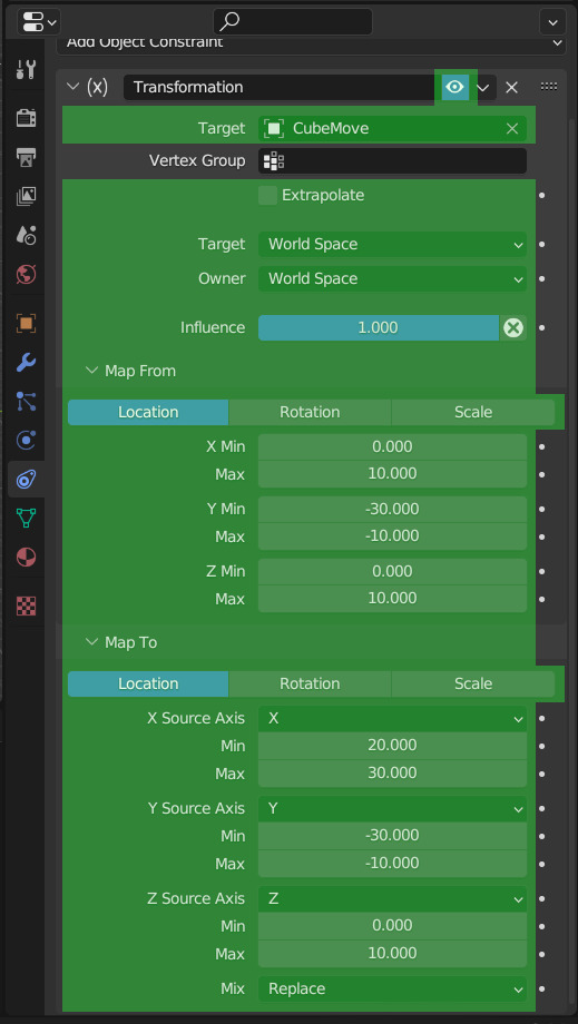

    Transformation
This constraint allows to connect one type of transform property (location, rotation, or scale) of the target object to the same or a different type of transform property in the owner object.

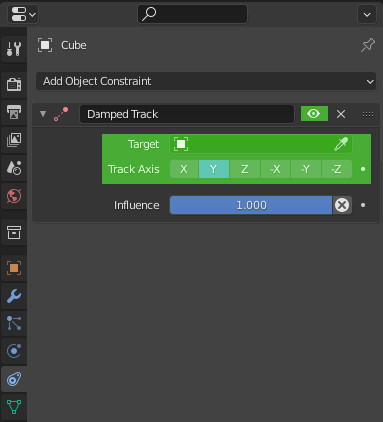

    Damped Track
This constraint constrains one local axis of the owner to always point towards Target. This constraint uses a pure Swing rotation, i.e. the shortest possible single axis rotation. In other 3D software you can find it with the name “Look at” constraint.

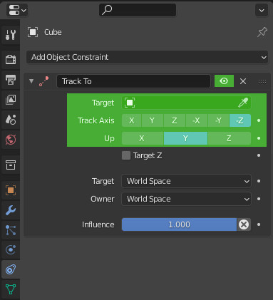

    Track To
This constraint applies rotations to its owner, so that it always points a given To axis towards its target, with another Up axis permanently maintained as much aligned with the global Z axis as possible. Thus you can implement billboarding with this constraint.

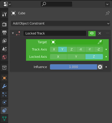

    Locked Track
This constraint works similar to Track To constraint, but with a locked axis.

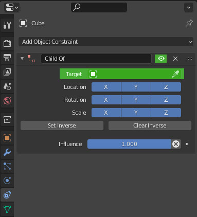

    Child Of
This is the constraint version of the standard parent/children relationship between objects.

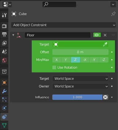

    Floor
This constraint allows you to use its target as a plane where the owner cannot go.

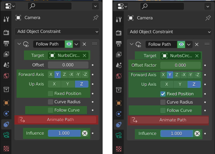

    Follow Path
This constraint allows you to move an object along the curve.
    Animate Path button is not supported, instead directly animate curve by keyframes.
